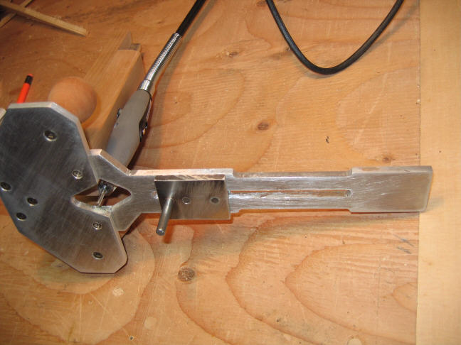

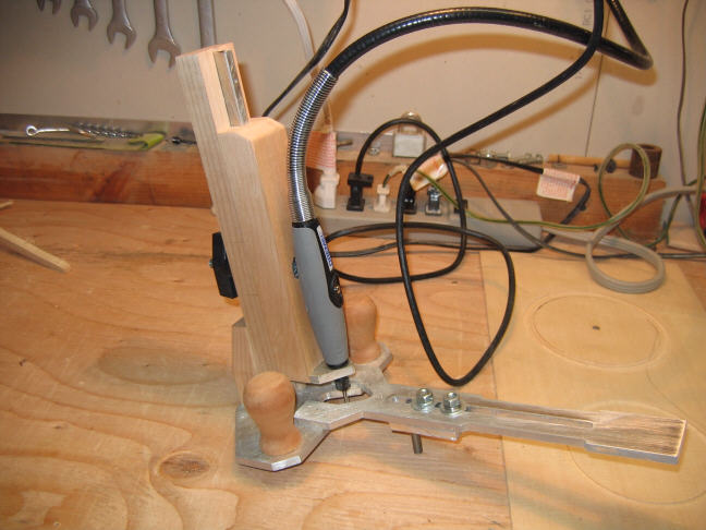

I destroyed my first two tops. All of the advice above is right on! Seal the top, I use hobby laquer in the aerosal can, quick, handy and easy. For the first two attempts I used dremel bits. The dremel burrs work way better on spruce than their mini router bits. Keep your dremel speed fairly high and go relatively slow but keep moving to avoid burning. My frustration in the first two attempts lead me to build this router base (it now has mac-tac plastic on the bottom):
And I bought stew-mac down cut spirals. There was a post a few months ago on MIMF about the new dremels and how they are equipped with a rubber bushing for the main bearings. This means that if you push too hard you can create some 'play' in the channel you are cutting. So when I built this base I uses the flex shaft which appearantly does not have the rubber bits.
I practised on scrap for each cut just prior to each line, I didn't cut shallow and then deeper but I used a 3/32 bit to outline everything. If you are using abalone with a purfling line on each side, do this whole thing and place it in a piece of scrap before you attempt to glue it down. I found this to be the trickiest part.
As everyone else said, make sure all of your cranks are CRANKED and your top is securely clamped.
Let us see the end result!
